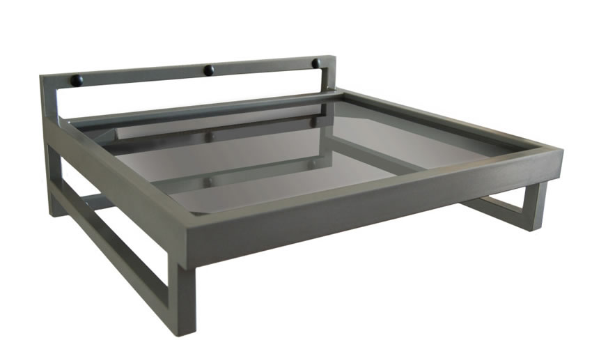

Hva med en Apollo WB1
Den skrues fast på vægen med 6 skruer. Glaspladen står på spikes. Jeg kan slå på rammen uden det går op i pick-uppen. Mit glas var dog gået i stykker under tansport, så jeg fik refunderet mine penge og gik ned til en glarmester og fik skåret en glas plade noget tykkere. Der findes også en model med to hylder.
Lidt info.
Details:
The Apollo WT1 Turntable Wall Shelf is a practical solution which every turntable owner should invest in. An isolation shelf can help you get the most from source components like turntables and CD players, especially if you have wooden floors.
This Apollo WT1 Turntable single shelf is fully welded for rigidity. Shelving is available in veneer MDF and is supplied with 6mm isolation spikes and sound absorbing pads.
Ever since 1975, when we realised that lifting a speaker also lifted the quality of the sound, Apollo hi-fi furniture has set the standard.
The Apollo WT1 Turntable wall shelf successfully combines the best technical expertise with exquisite good looks and engineered to give you maximum performance with flexibility.
You can hear the difference whenever hi-fi is placed on Apollo furniture. The sound is clear and unimpeded by vibration. Apollo has applied the same innovative thinking to all kinds of other hi-fi supports.
  • Useable shelf size W x D (mm): 460 x 380
  • Overall size W x H x D (mm):500 x 205 x 470
  • Max recommended 45kg with suitable wall fixings
  • Choice of crackle black, silver or antique gold frames with tinted glass
  • Supplied with 6mm top spikes and sound-absorbing pads

Kender ikke den der Apollo hylde, men generelt er glas noget af det værste man kan placere pladespillere eller andet hifi på! Absolut ikke anbefalet. Eneste undtagelse er en sandwich "constrained layer" konstruktion med f.eks. glas/gummi/glas.
