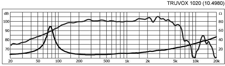

10'' højttaler TRUVOX-1020
Varenummer: 104980 | TRUVOX-1020
623,00DKK
Prisen er inkl. 25% dansk moms
Klik for større billede
Printvenlig
CELESTION
is one of the most appealing names in the world of speakers and the most interesting speakers of this traditional company are now available from MONACOR INTERNATIONAL. These speakers perfectly complete the wide product range offered by IMG Stage Line in some areas and thus an overall product range is now available which perfectly meets all requirements.
Professional PA midrange speaker, 300WMAX, 150WRMS, 8O
25cm (10") midrange speaker of high power capability from CELESTION, stable steel basket, equipped with a Kevlar fiber reinforced cellulose cone. Wide linear frequency response with excellent dynamic efficiency, suitable for all high-quality PA applications. Can be perfectly used as a bass-midrange speaker in compact sub/sat PA systems or in speaker systems for vocal sound, too.
TEKNISKE DATA:
Impedance (Z) 8O
Resonant frequency (fs) 77Hz
Max. frequency range f3-3,500Hz
Music power 300WMAX
Power rating (P) 150WRMS
SPL (1W/1m) 100dB
Suspension compl. (Cms) 0.14mm/N
Moving mass (Mms) 29g
Mech. Q factor (Qms) 4.79
Electr. Q factor (Qes) 0.43
Total Q factor (Qts) 0.39
Equivalent volume (Vas) 27 l
DC resistance (Re) 5.5O
Force factor (BxL) 13.53Tm
Voice coil induct. (Le) 0.7mH
Voice coil diameter Ø 50mm
Voice coil former Kapton
Linear excursion (XMAX) ±2mm
Eff. cone area (Sd) 363cm2
Magnet weight 42oz.
Weight 3.6kg

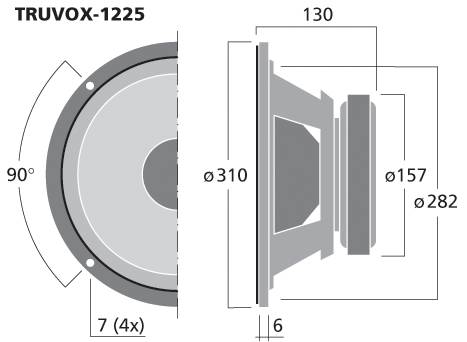

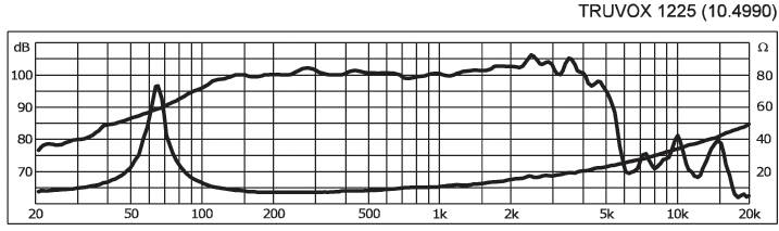

12'' højttaler TRUVOX-1225
Varenummer: 104990 | TRUVOX-1225
762,00DKK
Printvenlig
CELESTION
Professional PA bass-midrange speaker, 500WMAX, 250WRMS, 8O
30cm (12") bass-midrange speaker vom CELESTION of very high power capability. Stable steel basket, equipped with a Kevlar fiber reinforced cellulose cone. A wide frequency response with good attenuation, suitable for all general PA applications, with good limit frequency in BR cabinets of medium size.
TEKNISKE DATA:
Impedance (Z) 8O
Resonant frequency (fs) 62Hz
Max. frequency range f3-4,000Hz
Music power 500WMAX
Power rating (P) 250WRMS
SPL (1W/1m) 99dB
Suspension compl. (Cms) 0.13mm/N
Moving mass (Mms) 46g
Mech. Q factor (Qms) 6.57
Electr. Q factor (Qes) 0.52
Total Q factor (Qts) 0.48
Equivalent volume (Vas) 57 l
DC resistance (Re) 5.3O
Force factor (BxL) 13.72Tm
Voice coil induct. (Le) 0.8mH
Voice coil diameter Ø 63mm
Linear excursion (XMAX) ±2.4mm
Eff. cone area (Sd) 551cm2
Magnet weight 50oz.
Weight 3.9kg
