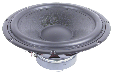

S 830668 10" Woofer - Coated Paper Cone
Only: $ 61.95
< name="add_to_cart_" value="Add To Cart" src="http://www.madi.com/images/cart/add_to_cart.gif" border="0" ="image">
Weight: 6.2 lbs.
PDFDownload Spec Sheet (46 kb)
Peerless 830668 10" Coated Paper Cone Woofer
Coated Paper cone
Rubber surround
Rigid stamped frame
Ventilated raised spider
Bumped back plate
Shorting ring
263mm flange
226mm cut out hole size
123mm depth
Znom 8 ohm
Re 5.6 ohm
Le 3.3 mH
fs 33.3 Hz
Qms 4.85
Qes 0.57
Qts 0.51
Mms 51.1 g
Cms 0.45 mm/N
Sd 335 cm2
BL 10.2 N/A
Vas 69.3 ltrs
Xmax 8 mm peak
Voice Coil Ø 39 mm
Sensitivity
2.83V / 1m 88.7 dB
Power (IEC) W
Magnet weight 0.87 kg

Ja, det er en udmærket enhed - hvis pladsen er et problem, har den en mindre 8" 'fætter', til en lidt lavere pris. Boksresultaterne er nogenlunde ens. Frequence i Århus sælger begge...
