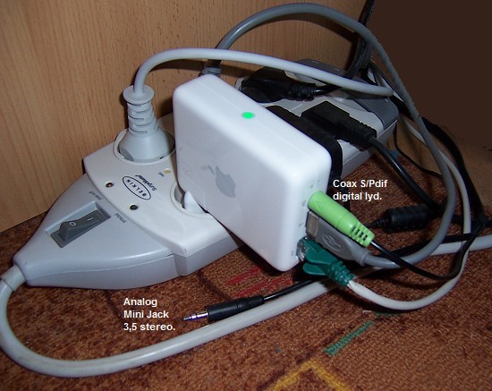

Airport Express Base Station. Pris 749 Kr. her
Setup video.  http://www.youtube.com/watch?v=xyUakC3WUOY
http://www.youtube.com/watch?v=giT_eGS54g0&feature=relat ed
