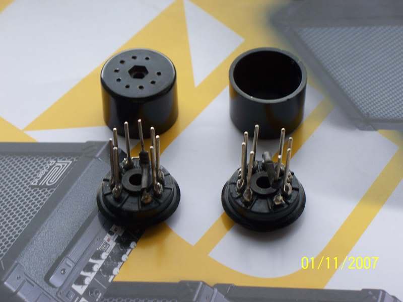

Sådan her
madmax
Bruger siden: 06 Oktober 2008
Indlæg: 1092
Sendt: 04 Februar 2015 kl. 15:20 | IP-adresse registreret
madmax skrev:
Sådan her
To use 12ax7 instead of 6n2p you just need to "redirect" pin 9 to pin 4 or pin 5. On this photo the first from the left is a 12ax7 adapter.
