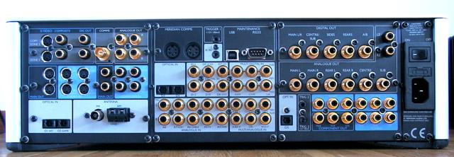

Det er en Meridian G68ADV med USB indgang til musik fra computer.
Link: Se side 8
  http://www.meridian-audio.com/media/199273/g68sl%20digital%2 0surround.pdf
Her er lidt kopiret fra linket
You can connect a Windows PC or Macintosh to the G68 via the
USB input to allow you to use the G68 as a digital audio output
device.
On a PC, Windows XP/SP2 or later is required. On a Macintosh,
OSX 10.4 or later is recommended. Linux computers that support
USB audio class drivers can also be used.
• Connect the computer’s USB port to USB INPUT U1 on the G68
using a standard USB A-B cable. The flat rectangular end plugs
into the PC and the square end into the G68.
The first time that the G68 is plugged in to the PC or Macintosh
it will automatically be recognised, and appropriate drivers will be
installed. The G68 will then appear as a sound output device called
Meridian 48k/16 in the Sound control panel (PC) or Sound
system preferences panel (Macintosh).
Note: The computer volume control will have no effect on the
playback volume; use the Meridian system control instead.

Nej din receiver bliver nu lydkort. Så Bare et USB kabel og du er "good to go"!

Præcis. Og den indbyggede DAC (lydkortet) i din Meridian er med stor sikkerhed væsentlig bedre end lydkortet i din computer
