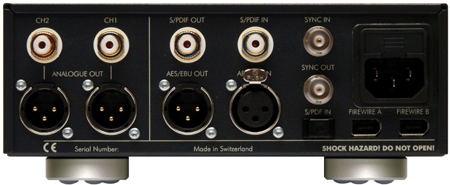

Du skulle måske også kikke på DAC fra Weiss Engineering, fx. Weiss DAC202
http://www.weiss-highend.ch/dac202/index.html
The DAC202 is a reference class Firewire D/A Converter with a IR remote control for volume control, absolute phase and
input source selection.
Features of the DAC202:
Digital Inputs: AES/EBU or S/PDIF on 1 XLR, 1 RCA, 1 Toslink, Firewire
Digital Outputs: AES/EBU on 1 XLR, 1 RCA, Firewire
Main Analog Output: 2 stereo analog outputs, one on XLR one on RCA
Headphone output on 1/4" Jack
Level control main output: 4 coarse settings via relays (analog domain), fine setting via rotary encoder (digital domain).
Level control can be defeated for the main output.
Level control headphone output: 4 coarse settings via relays (analog domain, independent from the settings in the main
output), fine setting via rotary encoder (digital domain).
Wordsync input on BNC connector
Wordsync output on BNC connector
Frontpanel controls:
LCD display for display of sampling rate, input source, audio level, absolute phase, upsampling filter type, various menu
items
Rotary encoder with push switch
IR receiver
Standby LED
Headphone Jack socket
Special features:
Transparency check (allows to check the bit transparency of a playback chain)
Setting of the coarse output levels (analog domain), separate for the main output and the headphone output
Dual / single wire selection for 176.4 / 192 kHz sampling rate
"Insert Mode" allows to loop in a external digital audio device (e.g. a equalizer) via the AES/EBU I/O on the XLR connectors
Sampling rate setting on the WSYNC I/O connectors in dual wire mode
Display brightness
IR Remote control switches:
power on/off
volume up
volume down
input sources (4 switches for Firewire, XLR, RCA. Toslink)
DAC upsampling filter type
mute
absolute phase
Sampling rates: 44.1 up to 192 khz / 24 Bits
The DAC202 also has a new D/A converter and new analog output stages
compared to former D/A Converter models. The D/A converter uses two converters per channel to gain in signal to noise
ratio.
DAC202 back view:
Size (approx.): depth: 30cm x width: 19cm x height: 8cm

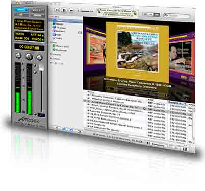

En af fordel ved weiss er at de køre god med Amarra player fra www.sonicstudio.com
http://www.sonicstudio.com/amarra/amarraplayer.html
Features ::
Supports up to 384 kHz sample rates
Automatic sample rate adjustment
Double-precision audio processing
RAM-based Cache for disk-free operation
Native FLAC playback & conversion
Advanced 4 band Sonic EQ
Choice of dither algorithms
Play CDs without Ripping
Amarra is $695 (USD)

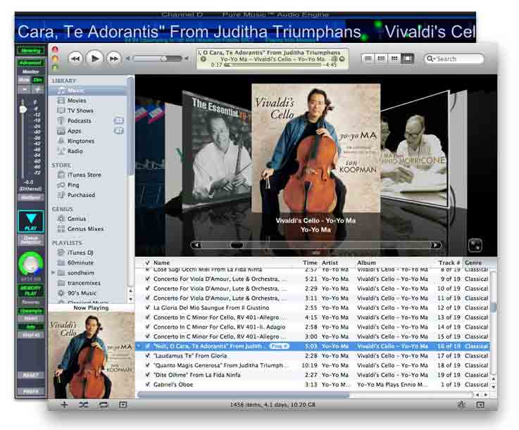

Eller Pure music player fra www.channld.com
http://www.channld.com/puremusic/
Pure Music®
High Resolution Music Server Software for Apple Macintosh Computers
2011 Absolute Sound Golden Ear Award
2010 Stereophile Computer Audio Product of the Year Runner-up (after Channel D Pure Vinyl™)
Simply and automatically docks with iTunes
Based on Channel D's acclaimed Pure Vinyl audio playback engine
Pure Music handles all music playback
iTunes acts as database, playlist organizer, etc. but doesn't play the music
Automatically docks with iTunes window
Supports Apple Remote App for iPad/iPhone/iPod Touch
Automatic sample rate switching
Gapless track playback and Memory Play
Adjustable Dithered Volume Control
Supports CoreAudio Compatible Sound Cards / DACs / Audio Interfaces.
Supports all iTunes Compatible Audio File Formats
Plays tracks from networked volumes
Optional REAL-TIME 64-bit upsampling
CoreAudio Device HOG Mode support
Internal Audio Device Selection and Setup (or use Apple Audio MIDI Setup)
Up to 384 kHz sample rate
Supports AudioUnit Audio processing plug-ins (parametric EQs, etc.)
Uncompressed audio streaming support (up to 384 kHz and up to four separate connections)
64-bit Adjustable 2/3/4-way Crossover with time alignment and minimum phase filters
Our own proven, optimized algorithms - not built from a patchwork of "open source" software
Optional FLAC file conversion and downsampling
Pure Vinyl's™ High Quality File Sample Rate Converter (downsample high-resolution audio to 96, 88.2, 48 or 44.1 kHz / 16,
24, or 32 bit files)
NEW features in Pure Music 1.8 (released on June 1, 2011) (FREE update) include:
The unprecedented ability (for Mac OS music server / audio player software) to directly play DSD format (dsf / dff, 64Fs and
128Fs) audio files (real-time conversion to PCM during playback)
"Playthrough," which permits conveniently playing other computer audio sources (Internet radio, movies, etc.) through Pure
Music, with full access to Pure Music's dithered volume control, 64 bit crossover, audio EQ plug-ins, NetSend streaming,
metering, etc.
Native device integer support
File format or sample rate conversion and adding FLAC tracks now operate on contents of folders
Improvements to Gapless playback, especially with FLAC files
General usability and performance improvements, and much, much more...
