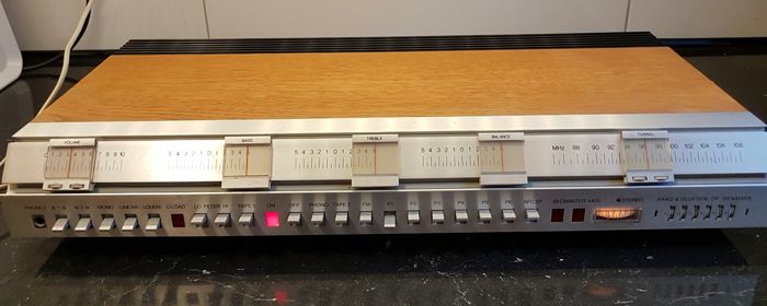

Beomaster 4400:

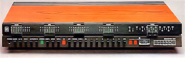

Beomaster 3000:

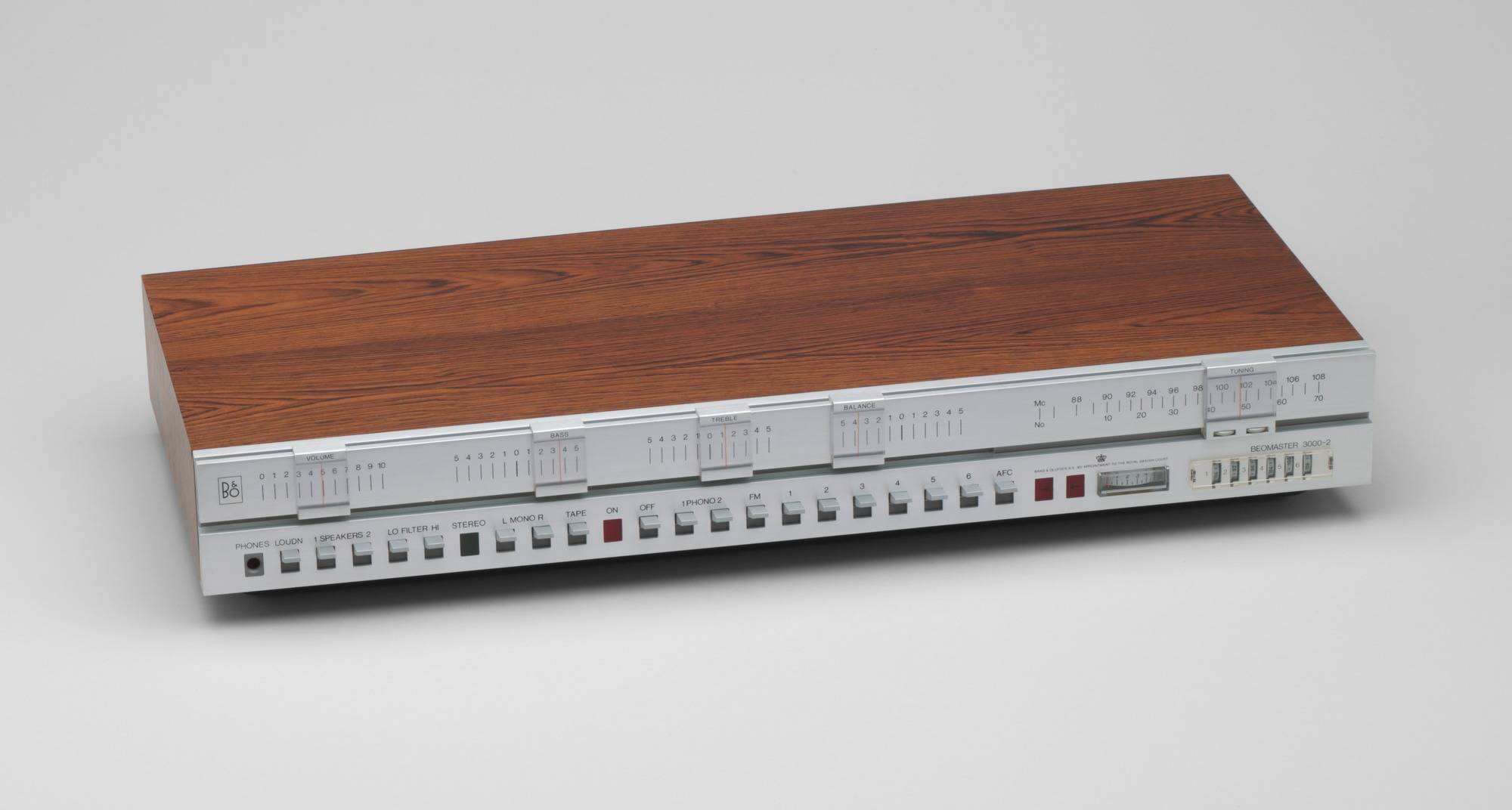

Beomaster 4000:
