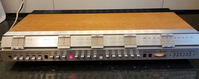

Beomaster 4400:

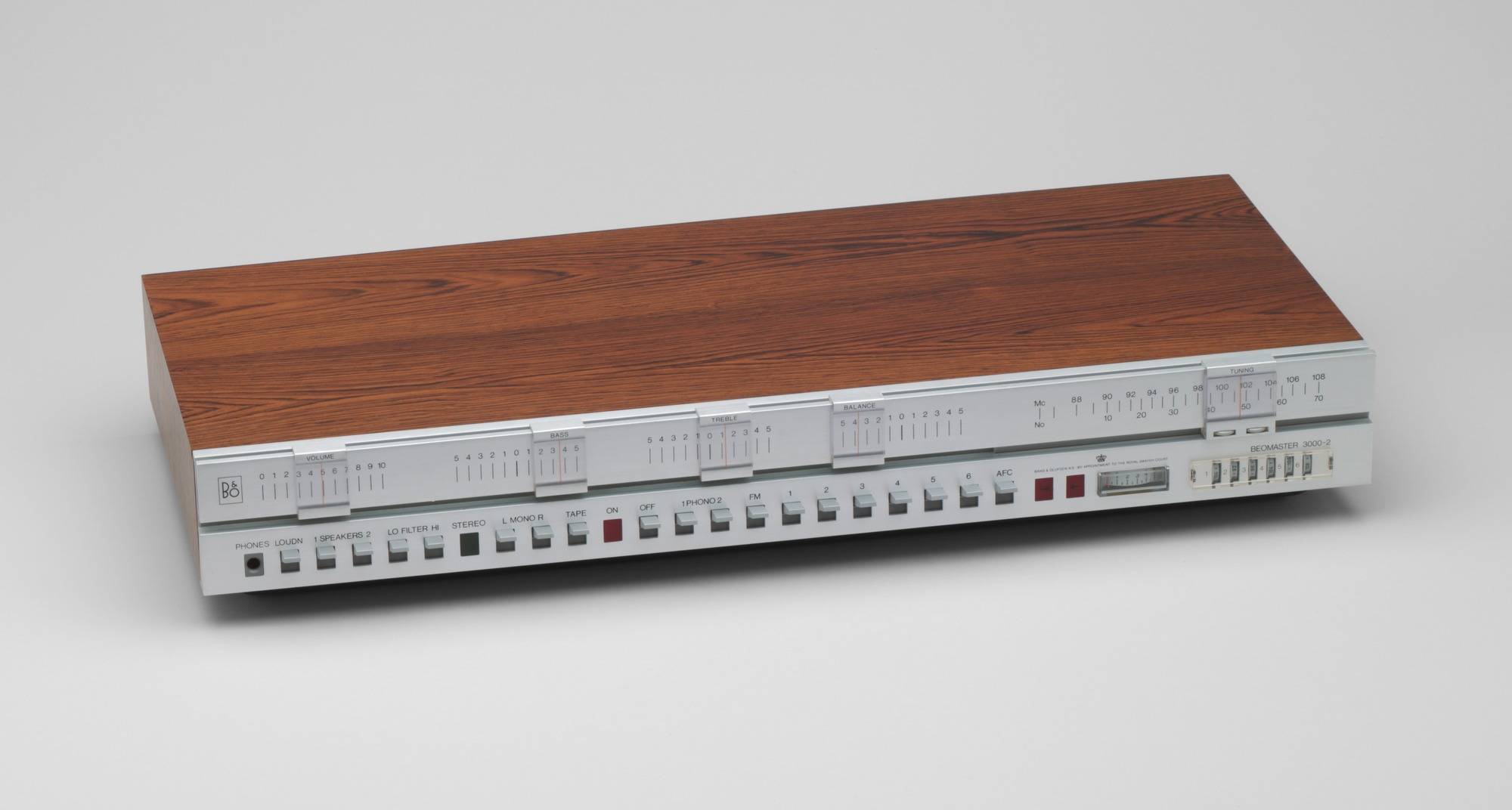

Beomaster 3000:
Beomaster 4000:
